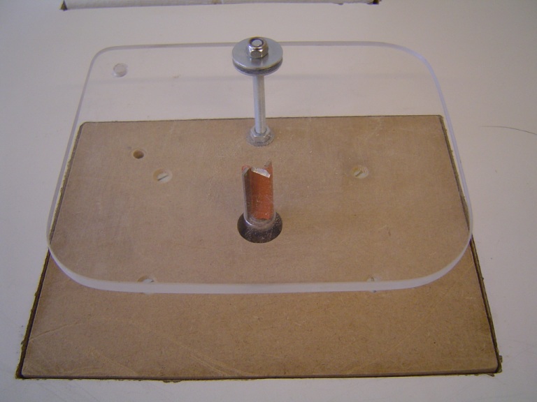

Do you have a picture of that bit for routing? Thanks.

I use a CMT bit with a bottom bearing for use in my built in router table. The bit with the top bearing would be for use with a hand held router. It takes no more than an hour to make a router table and like Bruce I can't overstate how handy it is.
This one is 1 1/4" x 5/8"
